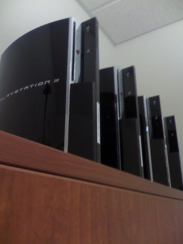

/\/\/\4 out of the 6 PS3s that were bought 2 years ago.

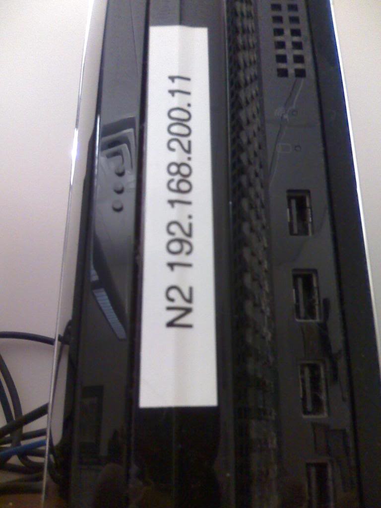

/\/\/\ The number is the IP

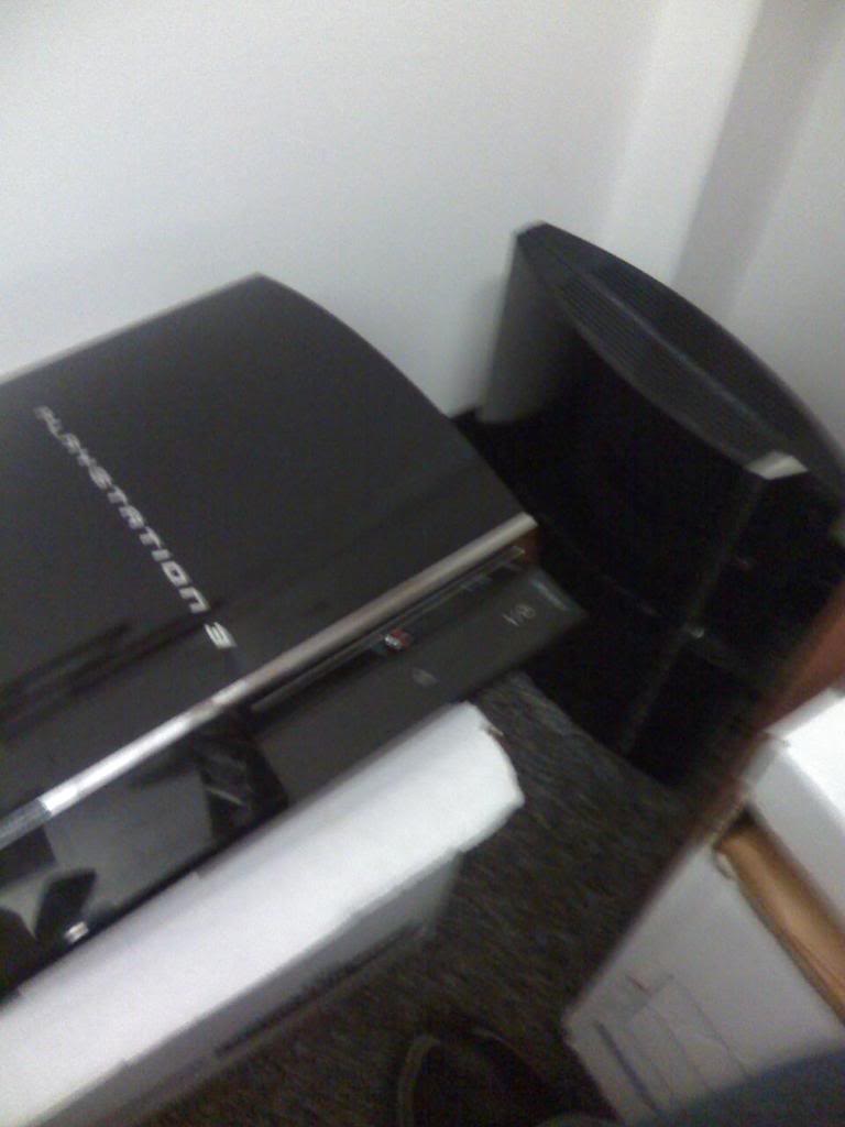

/\/\/\ Two that died from overheating
Obviously node5 has reverted back to the game OS, so the programmer at my dad's office is going to have a long night!! Taht is if you guys aren't going to help!!!!

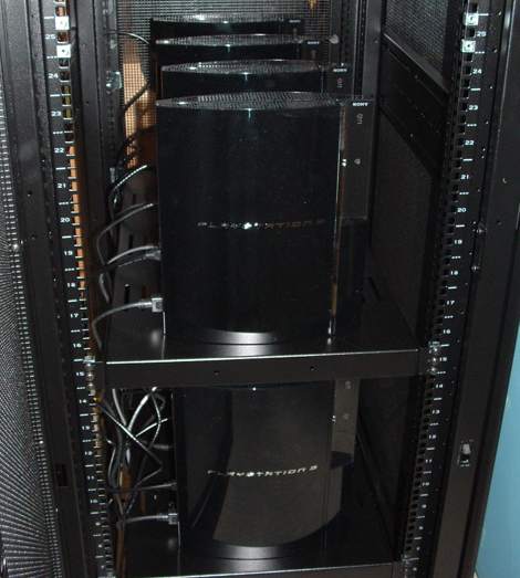

This is serious stuff, right? So it has to be rack mounted. But the PS3 is so tiny:
[photo courtesy of Prof. Khanna]
