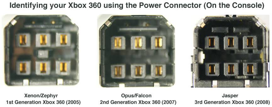

    Since the diagram only shows how to tell the Generation this is how you tell what you have.
    Xenon - Non-HDMI
    Zephyr - HDMI
    Opus - Non-HDMI
    Falcon - HDMI
    Jasper - HDMI

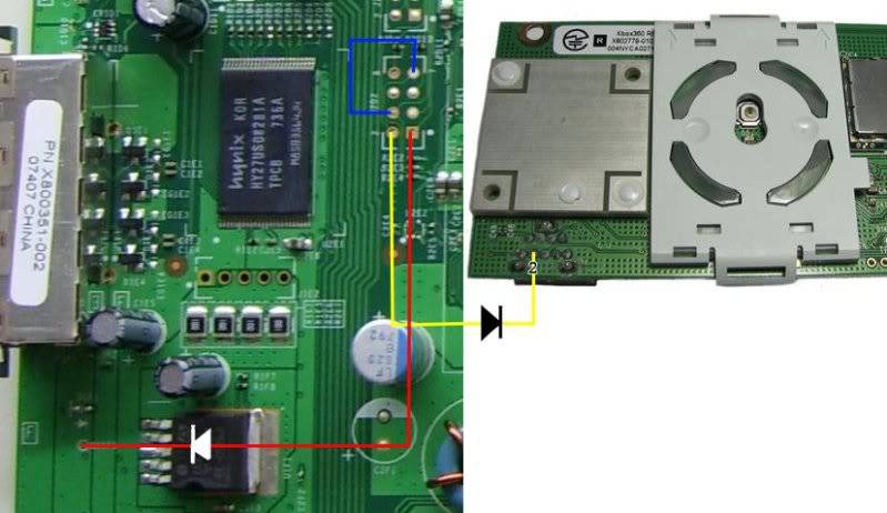

    You will need to know your Xbox Motherboard Revision. These are the two diagrams to follow. Each one of these will need to be bridged with a piece of wire and 2 of them require a switching diode.
    The |< is where the diodes go. On the diode itself there is a thick black line. That black line is this side ---> |< of the diode. That will tell you which way to place the diode when installing the JTAG connections. Diode
    MUST be soldered directly to the board facing the correct way.
    Xenon Motherboard JTAG Connections
    Zephyr, Falcon, Opus, Jasper JTAG Connections

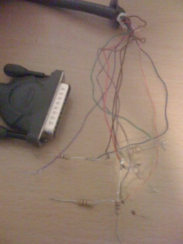

    1. We need to set up the solder connections onto the motherboard. I used a printer cable and cut it midway and spliced it open. Then used a multimeter to figure out which cable goes to which pin. I then wrote the color/pin combination on a piece of paper. If you decide to do the same as me and not make your own cable I suggest writing down the color/pin combo so you don't have to use the multimeter again.
    This is what my printer cable looks like.
    As you can see I have all the resistors soldered to the ends of the cable and the one diode attached as well. All I have to do is solder it to the motherboard and I have my connection to the NAND reading and it can dump.

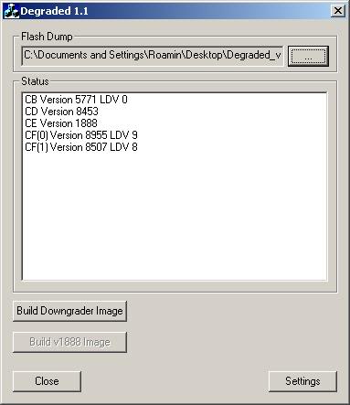

    Checking the CB Version
    This is a very important step for 360's with the 7371 kernel. Some of these 360's have been patched already to stop the JTAG hack. This is the way to make 100% sure whether or not your 360 is still vulnerable.
    Code:
    /XBOX 360/development/kernel/downgrading/
    Open your NAND image in Degraded1.1
    Your CB version will be displayed.
    Exploitable CB versions:
    1888, 1902, 1903, 1920,1921: exploitable xenon
    4558: exploitable Zephyr
    5761, 5766, 5770: exploitable falcon
    6712, 6723: exploitable jasper
    Non-Exploitable CB Versions (CD = 8453 for all of them)
    Xenon: 1922, 1923, 1940
    Zephyr: 4571, 4572, 4578, 4579
    Falcon/Opus: 5771
    Jasper: 6750
    NAND wont open in Degraded? Here is how to fix that.
    1) Make a copy of your NAND backup
    2) Open that copy in a hex editor
    3) At offset 0x0012 you will see 2004 - 2007 Microsoft Corporation
    4) Change that to 2004 - 2005 Microsoft Corporation
    5) Now you image will open in Degraded.

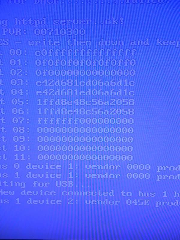

    Getting the CPU key.
    Have a camera ready to take a picture of the Fuse Set's that pop up briefly.
    Take a picture that includes fuse set 3,4,5,and 6. These contain your CPU key.
    Take either 3 and 5 or 4 and 6. This will make up your cpu key. 3=4 5=6 So for example. I will take 3 and 5.
    3= E42D681ED06A6D1C
    5= 1FFD8E48C56A2058
    So my CPU Key is - E42D681ED06A6D1C1FFD8E48C56A2058
    Adding either one of the two will make your CPU key.
