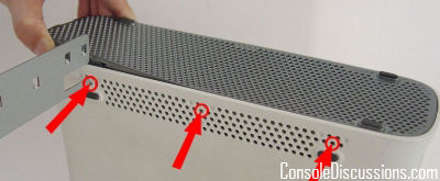

    Now there are 12 clips that keep the grill to the top and bottom of the 360 into place. Use the small flat head screwdriver to do this. You will find out that you will only be able to get about 10 of these clips open. This is fine and you can proceed through the rest the disassembly. When you fully have everything done you can simply reach in the back and unclip them with ease:
    Now look closely at the back of your 360. You will see small notches. Take your small flat head screwdriver or a flat pointed object and push it in the first notch to the left of your ethernet port until you hear a click:
    When you first hear the click sound you may think you broke your 360, but you didn't it will easily snap back together when we are finished. Continue on to the right until you get them all:

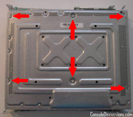

    Now that you have done that just remove the case and under it will reveal your reason for having a torque screwdriver. Simply unscrew all six of the screws I have marked with red arrows using your size 8 torque screwdriver:
