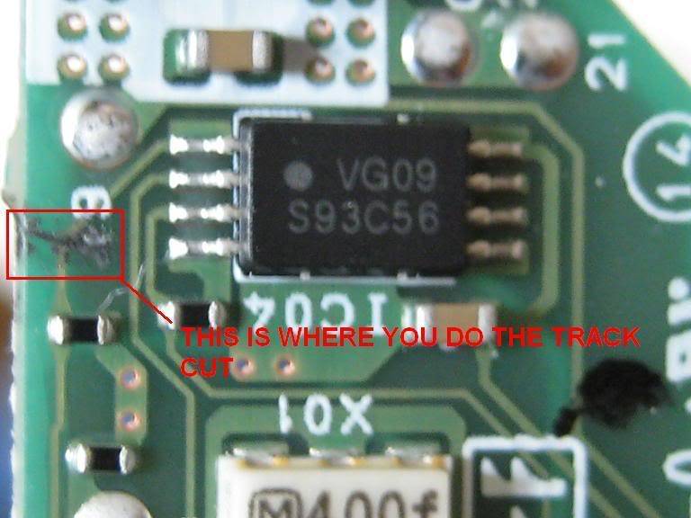

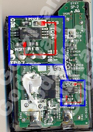

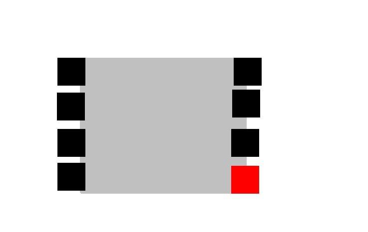

First:Make your pandoras
\/Phat,Pop the red pin\/
\/Slim,Cut the PCB Line\/
